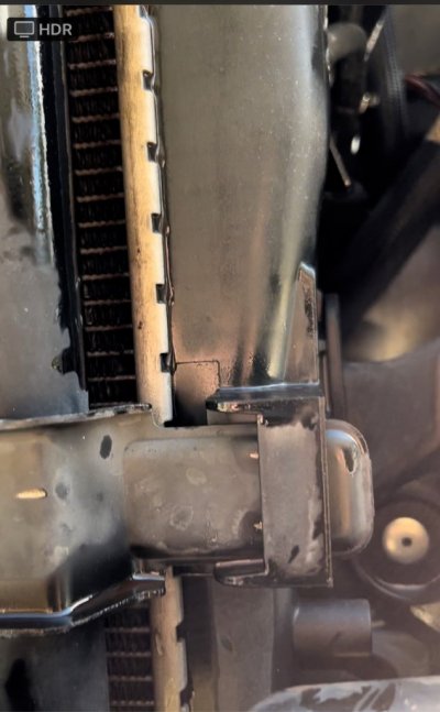

Thanks for the help trying to figure out to do it myself or take it the shop...need to know the name of if so i can get the part. so the one closest to the fan is not leaking its the second from the front

its a red fluid pretty sure its antifreeze

found it its the
AUXILIARY RADIATOR​

On the `13 & `14 cummins 6.7 they have 2 rads with engine coolant. 15+ went back to single rad. If you see a y in the coolant piping you have dual rads. Those y's have a reputation for developing leaks

Thanks everyone , it was the aux radiator and i replaced it ...id say 2.5-3 out of 5 difficulty pretty smooth im back on the road!
