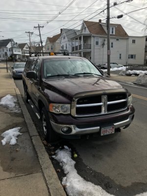

Chrisbh17
thanks for the info I know of going through the fire wall grommets was hoping there was something out the back under the seats. I just need 2 wires for a strobe light for plowing like I had on My 2004 ram truck. I should have a new fiberglass cap within a couple of weeks its on order and will put my racks on this one. Its where I bracket my strobe light to it. I take it off in the winter when done with the snow here in Boston. I will figure something out, was hoping to keep as much wire inside as outside under the truck side. Its all Teflon wire so I'll figure something out. Here is a picture of my 04 I sold 3 weeks ago and bought the 2013. You can see where i mount the strobe light its all led so not much current draw.
