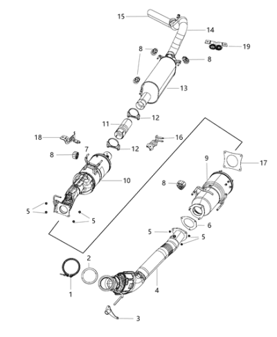

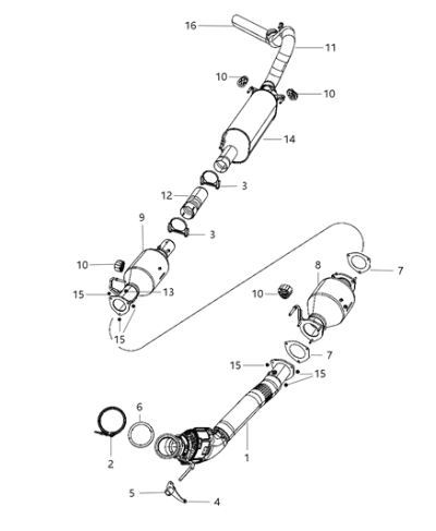

I have a 2011 Cummins 2500 crew. as most know that own a 2010 to 2012 Cummins, they are just a little different from the 2013. my question has anyone installed a 2013 straight pipe exhaust on their 2010 to 2012 ram. to me the bends look the same and has the hangers in similar locations especially the tail pipe. ill post the diagrams below, if no one know I will probably be the first to do this.

Not without modification. 2007.5 - 2012 fits, and 2013-2018 fits.
There's very little similarities between the 2. Exhaust hanger locations, bends, etc.. are different.

yeah i know the 07.5 to 12 fits. the problem is a 5 inch system costs 700 when i can get a 2013 for 350.
