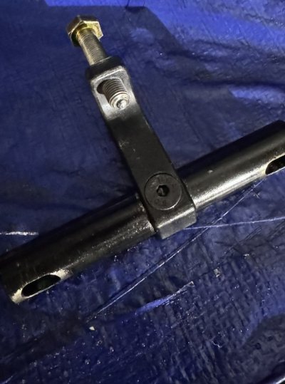

I ordered the spring compressor from mmx and the threads have stripped out after only 9 springs done? Wtf … I ended up looking things up right now and it looks like they resell a $25 tool from Amazon for $147. I’m so pissed right now. What a pos. So much for me trusting mmx ever again.
I kept spraying it down with pb blaster every couple of springs. I’m going to have to tap it and get a new bolt.
your heads are off use a regular cheap valve spring compressor harbor freight sells them c clamp kind.

So I ended up going to get a decent quality bolt and I tapped the tool slightly larger. I welded a little bead on the end of the bolt and it worked perfectly. The bolt has to hold against the insert where there is a depression so it doesn’t slip off the spring. I used anti seize on the threads this time. We got all the springs changed out. It rained a ton today so we didn’t get a lot done. Will have to finish it tomorrow. Not fun working in the driveway but it’s the only place I’ve got.
