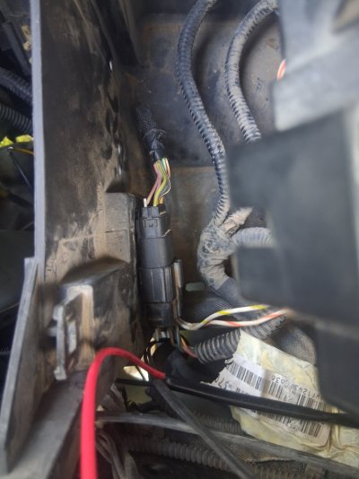

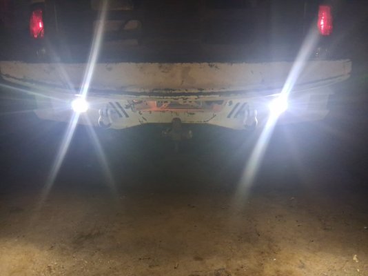

Activate rear fog via alfa obd.
Buy foglight switch if you don't have it.

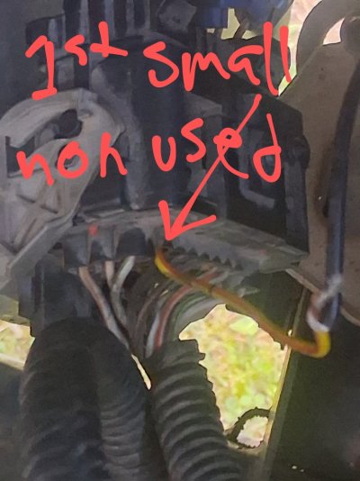

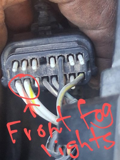

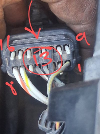

Run wire from the fuse box to the rear fog light.
Location:
Right rear fog light is under fuse box.
Left rear fog light is harness near radiator.
