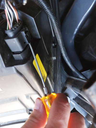

The first couple of times, removing the electrical connector was easy, but then it became a PITA.
After some experimentation, I found a simple method. I used a 1/8" slot drive, slipped it into the notched opening and gently pried up while pulling on the connector.
