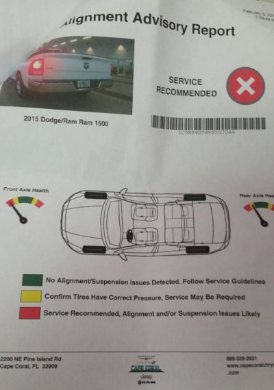

I bought my '15 SLT in Sept. of 2017, it had 28600 miles on it. When I was near 50k miles, I dropped it off at a local Ram dealer for oustanding recalls.
When I returned for my truck, the SA said I needed an alignment and showed me this:
I asked, "If my alignment is so bad, how come I have no pull, and my tire wear is flat and even?"
He stammered a bit and said, "You're not the first one to say this. Maybe our machine is off."
Yeah, rigggght. Maybe you just tried to screw me and got caught. Plus, that dealership was brand new and had only been open a few months at that time. Never been back.
Funny thing: My truck now has 185k miles, and I got 81k miles out of the last set of tires I bought at Walmart, Cooper Discoverer A/T "E" rated.
Also: I have NEVER had an alignment done on my Ram since I've had it, just rotating the tires every oil change. Still original shocks, too (those I do need to change, a bit more bounce in the girl, but money is really tight, now).
A giant upsell and money grab for them that was tried on you.
