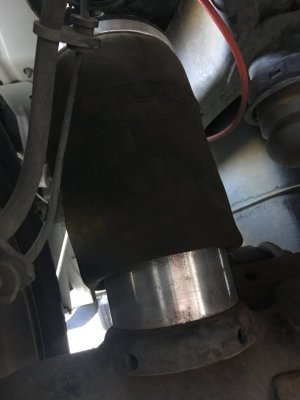

Hi Billy’s, yes I would be very interested as I want to go the 1223v with timbrens route. I just need to figure out how to remove the base on the the firestone air springs. I hate to pay somebody. Let me know more on what you have so I know they will fit as I would like to save some $. Attached is picture of FS base I can’t figure out how to get off- let’s chat more to thanks Greg

The 1223V's will work great for your truck. Are those aftermarket air springs?
they are Firestone airspring brand and I am removing them and just selling them. They work great for a smooth ride but I need more stiffness for my blue ox tow hitch.
