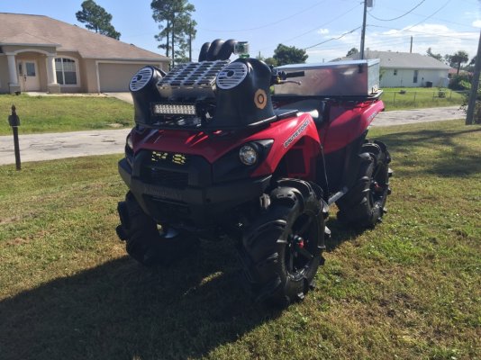

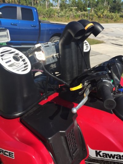

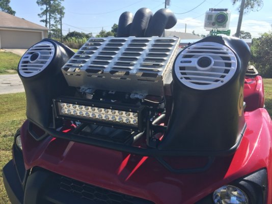

I build these speaker boxes for my Atv. They have 2 6.5" in each. 3a8868637ef6b2c52fd777766608e428.jpg727090a07270c4b6757411eefdfbf949.jpg2e6b7830f1f8201155a4635d54f15035.jpg
I think I'm gonna do a box like these with some shape lol.

Can't wait to see what you come up with.
