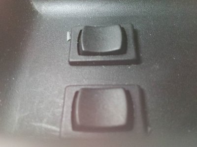

Ricks Ram
May 1, 2015
4,411
3,415
12sportmc's writeup is great. He used the power sliding rear window switch to control both mirrors simultaneously. My writeup is similar but I mounted two momentary mini switches in my door panel and can control each mirror individually if I chose. Either way is fine its just a matter of preference. His way is actually a little easier because there are less wires to run. Using the power slider switch was a clever idea. I installed a power sliding rear window as well so my power slider switch wasn't an option.

I read thru that whole post and I'm still not sure what parts I need or even if it can be done to my truck? Lots of confusion in what works on what years. Mine is a 15 Express w/power mirrors only, not folding, not heated and without the temp sensor or turn signals. Not real sure on the cost of all that's needed vs some of the other things I have planned either? I'll have to think about this.
12sportmc
Oct 21, 2016
797
356
NC
Your truck has the temp sensor in the drivers side mirror. All 13+ do. The power folding feature is what the DIY is for, I also did not have that feature from the factory. If you buy the mirrors with heated glass, signals, and puddle lights you would need your dealer to flash codes LEC and LEB to make those specific features function but is NOT required. The power folding part is what you would be doing on your own with no dealer involvement. Your splicing the two wires at the mirror harness connector at your door module. I have 350 total in my upgrade. I bought used mirrors and used over head panel and had my codes flashed for 45 bucks at my dealer (prices for flashing will vary from dealer to dealer) You can do it cheaper if your use a DPDT switch, they are about 2-5 bucks depending on how "fancy" a switch you want. Hope this helps and keep asking questions man, there is a wealth of knowledge and people on this forum that "have been there done that " to their trucks and are ready to help you out[emoji106]

So if I install the window switch panel w/mirror fold button and adding the codes still won't work? If not couldn't I just vampire off the wire harness in the door or is that the whole point, no wires are there for the fold option?
12sportmc
Oct 21, 2016
797
356
NC
Correct you CAN add the new modules and OEM switch , but 99% chance dealer will not be able to flash for you. Confirmed this w/Ricks Rams who is a tech. The wires you will tap into are located on the black plug from the actual mirror harness that runs to the module in your door. I'd recommend you pull your door panel off and just familiarize yourself with the module location and plugs I'm talking about. It might clarify a lot of the guess work for you. Door panel takes about a minute to pull off Your current set up will only have one connector if you have just the basic mirror with heat and power movement , the power folding mirror will have 2. You WILL be able to get the codes flashed to your current modules for the puddle lamps, turn signals, and the flip up correction for the mirror controls while you have them in goal post mode lol. Let me know if you need some pics to help orient you on where to splice and I can pull my door panel off tonight or tomorrow and get you some.
