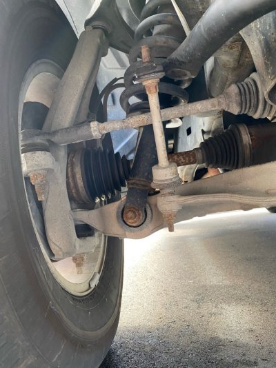

can someone please send me a link to a replacement for this from rock auto? I'm not sure what is it called exactly but I think it's a stabilizer bar end link at the front passenger side. Thank you.

Should also replace bushings in stabilizer bar but they make 2 different sizes
Put your vin# in the link below & check vehicle options that describe your Ram for correct bushings then copy & paste that number to Rockauto
H
Hattan
Oct 23, 2021
70
23
45701
You should replace both sides........below is correct # if you have no lift......made for factory specs
I already placed my order with one stabilizer bar and trying to see if I can change it to two instead so far no luck. What happens if I do not change the bushings?
