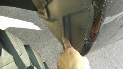

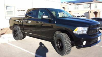

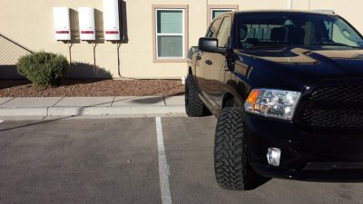

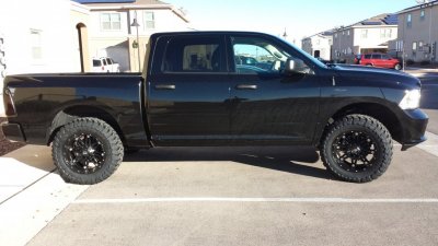

Update with pics and measurements
Not sure how the pics loaded. Only one I really wanted express was the inner fender pic. It is pointing to the driver side inner fender were im rubbing. Which the toe on the driver side is noticable. So the alignment just might solve that issue. Now to give some measurements
1.front fender 40.5 inches/rear fender 40.5 inches(so im level exactly)
2. Middle of drivers door handle 49 inches
3. Bottom of mirror 56 inches
Hope these are useful. just to recap I installed bilsteins maxed, fuel hostage 20x10-24 offset backspacing 4.5 with toyo mt's. Ride is smooth better than expected. After 20 miles on the new tires mpgs hasnt budged 11.9 which is my normal highest is 13.0 this is all city. If any one has questions just ask. Ill to give my best input.
