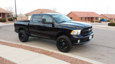

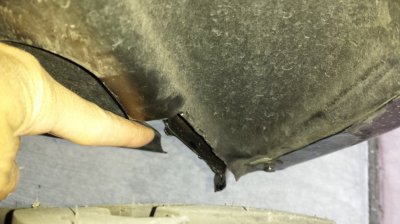

Alingment did not fix my problem. I dont have the funds right now for a bl. So I just cut plastic inner fender. I did find however that the driver side inner fender stuck out about half an inch more than the passenger. Thats why it only rubber on the driver side. So with being said I will say u can run 35's on a 2014 4x4 1500 on 20x10 -24 wheels. Not really a big deal just some thin plastic. And no rubbin! Pic one is a 2014 4x4 cc 1500 no mods next to mine. And second pic is where I cut the inner fender.

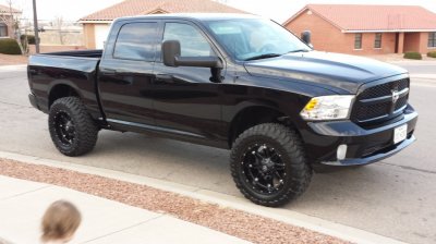

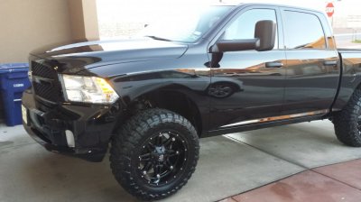

new mods complete
Vararam, bodylift, and tow mirrors installed.

Thanks guys for comps. The mirrors were a lil high. their the spec-d tuning and $350 is what I paid. Just beware if u own a 2014 the temp sensor will have to be removed from factory mirror.
