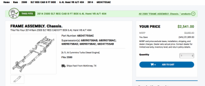

A quick parts lookup and they are the same part number for diesel or gas.
You didn't specify the transmission so I went with the manual transmission but it's the same part number for the automatic.

Oh that's interesting. On the Moparpartsgiant.com site it lists different part numbers for the gas and diesel and they aren't the same as the ones above.
I found the site you reference below:
Now I'm a bit more confused. Looking on the "what this fits" tab it says that frame pretty much fits gas/ diesel, crew/ regular/ mega cabs, manual/ auto, and 4x4 and 4x2. I know that can't be the case from looking under mine and seeing the raised front bed mount brackets. I guess the crew could use the same rails but would need an extra cab mount.
But in any case, I just need to verify that diesel/ gas reg cab 8' beds are the same.
This was a like for like parts search. Plug in the VIN and you'll get an exact match for what you're looking for.
