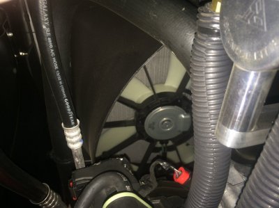

Ok peeps I got from two great sources that on the 14s the efAn is the same size as the v6 efAn so don't waste your money! I removed my clutch fan ended up using my air hammer to get off (very easy) and poped out the bottom of the shroud and very easy. Have your tuner set your efAn temps mine come on at 195 and turn off at 185 degrees. Works like a charm!!! Oem quality already there. And the factory shrould is fine. image.jpg

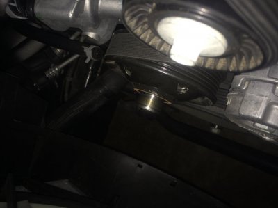

Does anybody have a source on a cap nut I can buy to protect my threads were the clutch fan screws on?

I didn't get a tape measure in there but my stock efAn is huge, bigger than my clutch fan. image.jpg
