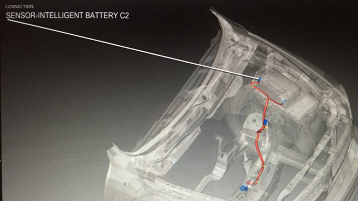

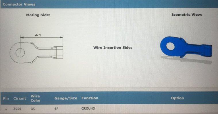

The ground is directly linked to your negative battery post clamp. HTH
