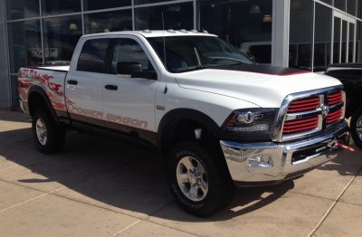

Here is a pic as well, just had to do it. I know the graphics are a little over the top but they didn't have a tradesman and my wife really wanted something to stand out (think I got that covered now).
Also long term thinking little bigger lift and tires, maybe when the aftermarket catches up there will be some heavier springs that will lift and improve payload :)
Yeah, that thing won't hardly carry a sack of cement, so you'd better sell it to me for fifty cents on the dollar:naughty:
