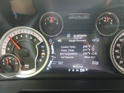

Hello, first time posting to this board, I have a situation that has happened twice now that I think could potentially indicate a failure mode with the 2014 Ram 1500 8 speed transmissions cooling system. I call it a “spike overheat”. What happened to me is that I was driving along I-10 in Texas at 80 mph (the speed limit actually) and the transmission temperatures dramatically began rising. In this case the transmission got to 230F before I found an exit and pulled over. As other posters have noted the solution is to let the vehicle sit and cool and once the transmission gets back to normal operating temps you are fine. I knew this, of course, because I am actually on my second thermostatic valve and transmission oil cooler. I knew also, that once a spike overheat happens that you have broken the thermostatic valve and it will continue to happen until its replaced.

My trans hit a record a few months ago with the wife and kid.

I'm also from Houston, TX, and what first happened to you just happened to me. I had it in +/- 8th, cruising down south to Brownsville, when I casually looked down at the gauge summary and saw my transmission at 230 F (coolant and oil temps were normal). At steady state on the highway it normally stays rock-steady at 185 F, so this was GREATLY alarming. I pulled off the highway into a truck stop, and noted that as I was slowing down, some of the down shifts were kind of jerky, which has never happened before. Even as I was slowing down I saw the temps start to fall. I parked it, got out and took a look under to see if it was leaking transmission fluid, and it was bone dry. After sitting parked for about 15 minutes, the temp was back to about 185-190 F. Not knowing what else to do, I got back on the highway, leaving it in 'D' this time instead of "+/- 8", and the temperature actually ran cooler than normal at 181 F until Kingsville (2 hours away) where I stopped for lunch. From Kingsville to Brownsville, another 2 hours driving in 'D,' it rose back to 185 F and held there like normal.
