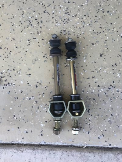

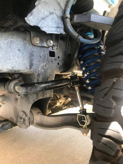

Got my Spmaxx sway bar links switched from the long version to the standard version, not that there was anything wrong with them but i wanted to experiment with a little flatter sway bar angle. The new ones are supposed to be stock lenght.
Old vs new

See! Boredom does this! It's all for science!
Those things still click and clack on you or you iron that out?

and I'm sure they still click but i'm so used to them i don't hear them often. i could almost swear i haven't heard the new ones click yet though.

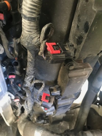

Changed my spark plugs today at almost 80k miles. Took me 3 hours with the spark plug tool that i guess everybody is using to do the job with the Hemis (Thanks goodness that chit exist), did it from the top and had to literally lay down under the engine bay, having a tube bumper helps a lot :) Unfortunately for me i broke one of the read retainer clips holding the coil pack connector chit. Dear lord i watched the darn thing in slow motion jumping out and hidding somewhere behind all the engine junk.
This is an example of the clip i'm talking about. The one i broke was the one at the rear on the passenger side
48648345666_4ef9490641_k.jpgUntitled by RAM RSM, on Flickr
I wrapped a zip tie around it for now
48649305633_5898e837a8_k.jpgUntitled by RAM RSM, on Flickr
Ty to Jimmi07 for posting the link with the connector
https://www.mouser.com/ProductDetail/TE-Connectivity-AMP/184270-1?qs=9yI11AV48ZTKubsvDXAlCg==
Hoping it won't be too difficult to swap the mother facker out. I only needed one but knowing my luck i ordered a 2nd one just in case :)

Do you notice any difference?

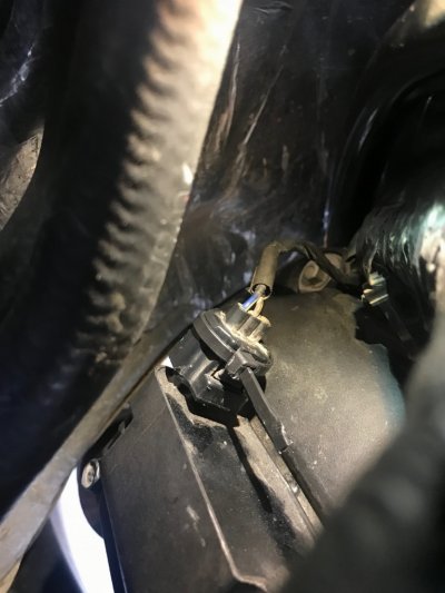

Checked online with a couple of junk yards but they didn't have anything with the newer Hemi that will have the connectors with the red clips. Did more research online and found a Mopar part # which is supposed to be full connector rebuild kit, Mopar 05019952aa. Called the dealer and they said they had one so i drove up there to check it out. The connector fits in the coil pack but it doesnt have a retainer clip because it seems to use a different system to lock, plus it's $45 + tax so i didn't buy it. It would have been a different story if i had the damn red clip lol oh well.
I'll wait for the connectors i ordered yesterday from Mouser, i'm hoping they'll have the retainer clip i can borrow from them.
If not i've already secured the connector to the coil pack with with anoter zip tie., no way that sucker will move anywhere now.
I'd like to think so :) but i did it with the thought of preventing the last 1/2" of shock compression.
If you check post#298 you can see i had a 1/2" gain at full compression with the longer sway bar links, no bueno with the 37's. Tested today with more speed through the rough spots at my local testing ground and so far she seems to be good between this and the little massage i did with the hammer to the fender lips.
