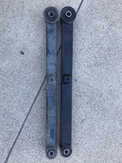

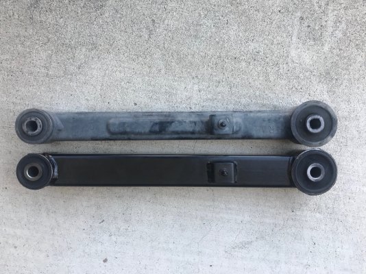

Got the rear control arms installed. I think i'll return the other stuff i bought. everything looks good down there so might as well pocket the money back and use it for something else. The bushings while not new (truck has 80k miles :) ) had still some more miles to go.
I'll wait another 20k miles or so to resfresh the front LCA's, tie rods, etc.

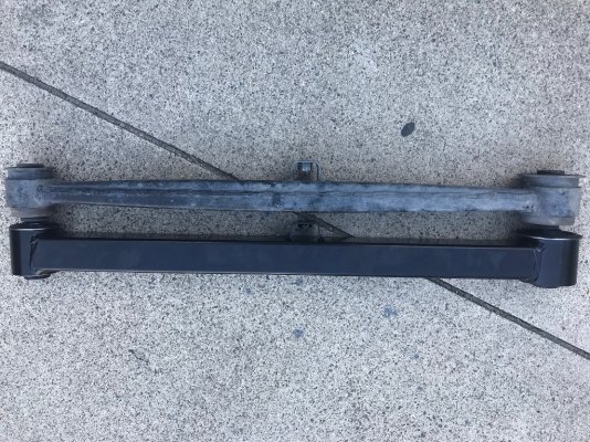

Wanted to post the factory lenght of my RAM 1500 CC rear control arms measured eye to eye
Uppers are 16 3/8"
Lowers are 23 3/4
Also caught a mistake i did yesterday when i got the fackers installed and placed the LCA big end sides towards the frame when they should have been placed towards the axel. Don't know if that makes any difference but i just flipped them today to match what the factory did.
This is what i'm talking about, if you click in the pic and zoom in you'll see they're labeled at each side, For the uppers the big bushings are supposed to be oriented towards the frame while the small ones go towards the axels.
For the lowers is the opposite, the big ones go to the axel and the small ones go towards the frame. I had placed the lowers matching the uppers, so i corrected the mishap this afternoon.
