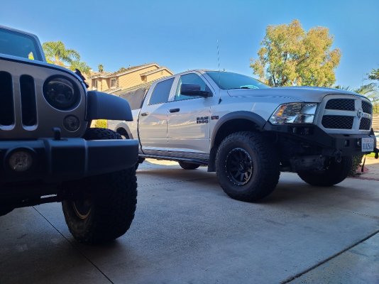

Damn haven't updated in a while, very busy upgrading the Jeep For now is just an spacer lift, yep you heard that right, spacers :), but welll thought out setup for now as not to upset the live axels geometty very much. i just needed to accomodate the 315's so the front is 1.75", back is 1", no need to mess up with adjustable trackbars and/or TB relo brackets that way. i went with longer shocks in the rear, stock in the front, but that's because i'm getting a new longer/sturdier driveshaft. Also had to spend money on tires, Got KO2's in 315/70/17 again, and i'm doing 4.56's front/rear tomorrow.
I did Synergy Fixed LCA's in the front, but more likely i'll sell them an get Claytons front and rear., and i have a bunch of other chit coming in. Clayton don't have fixed lenght LCA's, so i went with Synergy for now, Getting me a set of rock sliders in a couple of weeks, control arms skids, belly pna skids and shell be ready to hit the rocks.

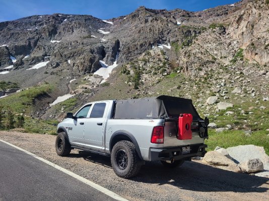

Came out from our 1600 mile round trip to Yosemite. We had a blast, the truck behave impecabbly as always, knocking on wood. Knocked out the Sonora Pass and the Old Priest road out of my bucket list of "Dangerous" roads to drive lol. Sure you wouldn't want to get caught in these roads when there is snow in the road that's for sure.
Sonora pass has a couple of sections with 25-26% grades, Old priest road is 20% for the entire 2 miles.
I was checking my coolant out of curiosity in those2 miles going up since i have stock T and clutch fan, truck fully loaded, Ac full balst i pressed the tow/haul switch and i let her go up.
