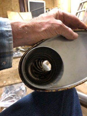

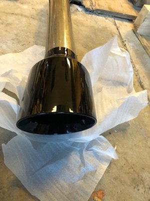

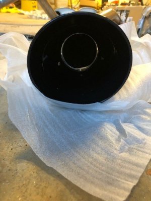

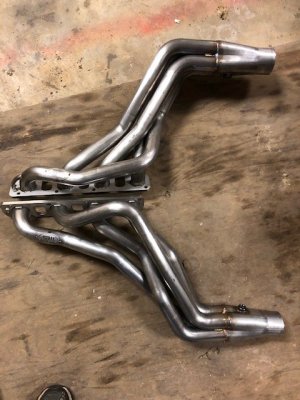

Following to see what you have to chop to fit the exhaust in er.
According to Stainless Works, the header kit will fit the Ram even with it being 4x4. The exhaust kit is long enough to fit a crew cab and the some of the straight section on both sides of x-pipe will need to be cut, but it will fit.
Yup, didnt say it wouldnt fit, I just want to see how it goes and not loose the thread in the masses of posts. :grd:

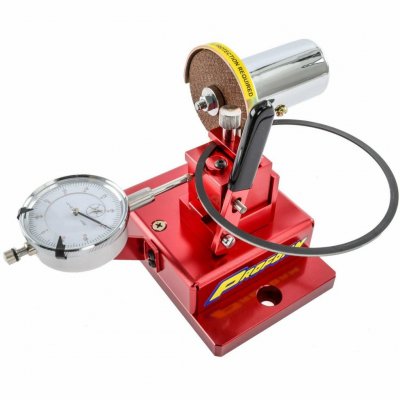

Just purchased this. Watched several videos and seems simple enough. I'll just have to get a gasket set and a few more miscellaneous tools to re-gap the rings. Seem a shame to break down a new engine but I want to get this done right.
Thanks again Wild one!
Allow yourself lots of evenings to gap the rings 78,it's a very slow tedious job,been there/done that a few times,lol. I'm just gonna throw this at you,but if your budget can handle it,it'd almost be worth while to swap in a blower specific cam and a new set of lifters while you have the engine tore down that far.It'll make your Whipple all that much more efficient. Ryan Hogan of Flying Ryan Performance or Jay Greene of Greene Racing or any decent tuner shop would be good guys to talk to about a blower spec cam. BTW you're the only guy in the Hemi world that calls a "Whipple" a mild mod,most guys call a blower the higher end scale of a radical build,lol

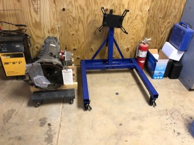

Transmission came yesterday but the torque converter was missing. The freight driver was driving around for a few days trying to find where to deliver it to. It was wrapped but had some slack in the strapping and wrap. It was shipped from California to Georgia so they don't know if they forgot to add it to the shipping or if it fell off.

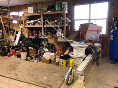

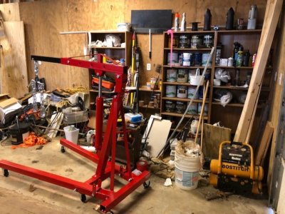

I've been needing to do this for a long time. The shops always been a "throw all" storage place. I'm going to build a shed to get this room cleaned out and ready for the build. I'll be taking the last week of this year off to get this done.
For now though, the compressor's set up, hoist & leveler assembled, engine stand ready. I'm slowly collecting the specialty tools needed that I don't have. The end ring gap came in a few days ago.

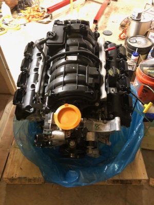

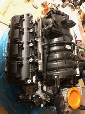

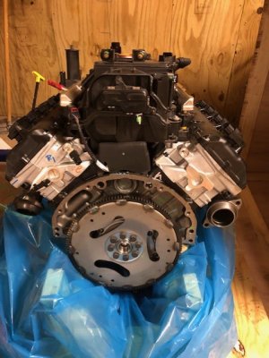

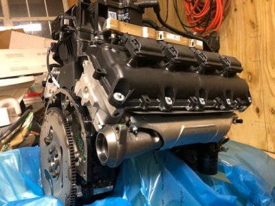

Engine arrived yesterday. This thing is sweet! It's pretty much a plug and play engine. I need to order the forged piston & rod drop in kit and a MDS custom delete kit. Once the shop is in order, I'll take my time and begin the build.
View attachment 230642 View attachment 230643 View attachment 230644 View attachment 230645 View attachment 230646
If your budget will handle another hit,ARP makes some pretty decent head bolts ,might be a worth while upgrade seeing as how you're going to have the heads off anyways.They do make a stud kit to,but it's probably overkill if you're not going to go over 12lbs of boost,plus you'll hate the studs if you ever have to pull the heads off down the road.I'm running the ARP bolts on my nitrous fed toy,and have never had any head gasket issues with them.
