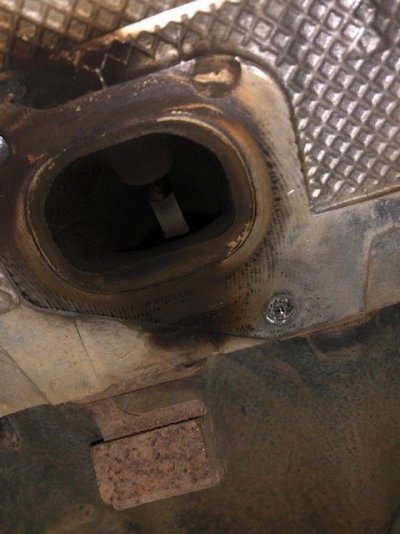

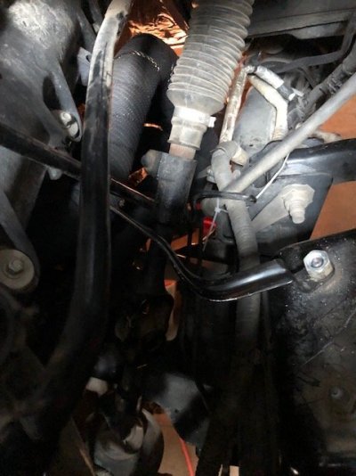

Well this sucks!! I've had the warped exhaust manifold issue, both sides... One outie and 4 flush with the head. What's the best extrusion tool brand do you all use? I'm almost temped to re-gap the new motor and slap it in... But I really want that nasty sounding cam to go with the build.
I know I'll heed a 90* angle drill to get in there and some good bits to drill into those case harden exhaust bolts. Any and all recommendations are most appreciated!!
Thanks in Advance!

Weld a nut and washer to it,if you don't have a welder,scrounge up a buddy with one,lol

Well, I would have never thought about that! Just watched several videos on this and it seems to work quite well. So far 2 out.

The last broken stud was the one on the passenger side that holds the oil dipstick up top. 4+ hours later and after purchasing a angle drill with tips (wasted time and money), and going through several nuts... Success!! The passenger side is on and clearing with some minor adjustments on the transmission lines to get the clearance.

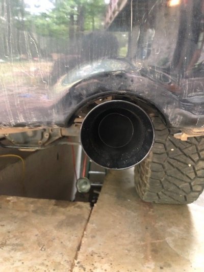

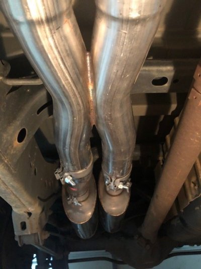

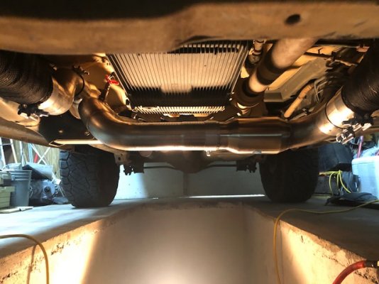

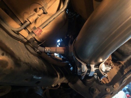

Well that was one tough install!! Finally completed and sounds great!! Also install the **** for the AF sensor.

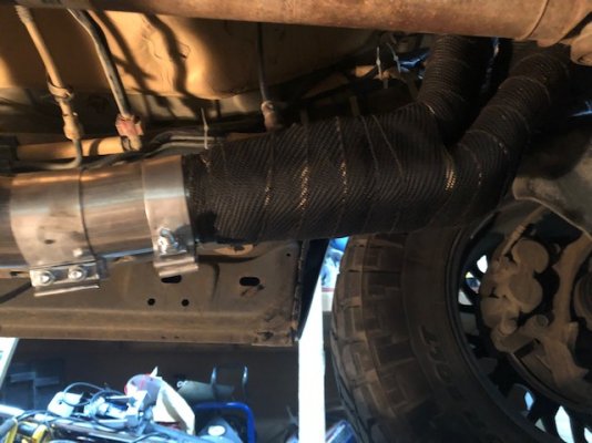

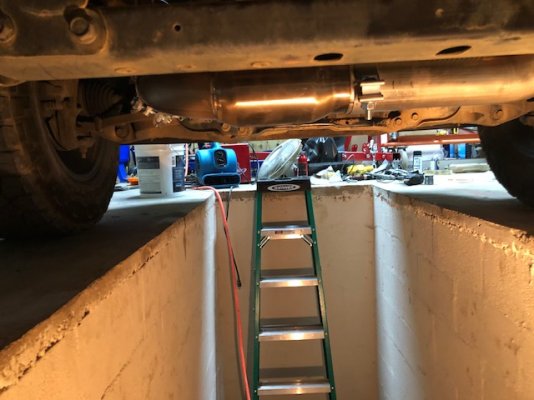

A few more shots.

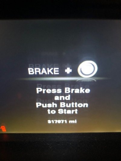

Well after checking things out first thing this morning, I drove just under 100 miles and all was well! The Ram Screams!!

Wow, this is an awesome thread. I just read it from the original post to the last, and what a journey!
I want to ask you something: what kind of oil and filter combo did you use on your engine that you made it to over 300,000 miles with it without any issues? And what OCI are you practicing? Thank you!
Thanks!
I have always used Mobile 1 & the larger Mopar oil filters. I average around 15,000+/- on my OCI.Oil 317K.jpgoil.jpg

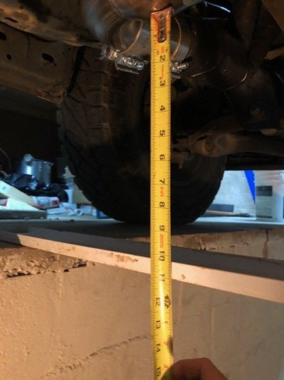

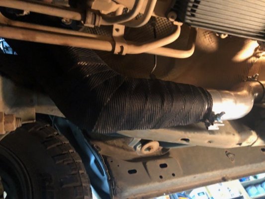

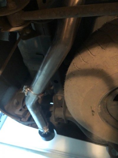

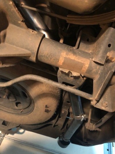

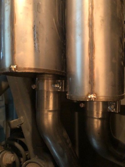

What are your thoughts about the Drivers side exhaust dipping under the drivetrain like that? It's looks like it's going to get caught on something. Exhaust and Long tube headers are in my future.
And don't forget about Enchanted Eddie's question too! What oil / filter u using?
It only about 1/2" lower than the front crossmember. It can be installed closer to the transmission but I chose to maximize the gap. I'm setting 2" higher than stock because of the 37" tires so I'm not to worried about it.

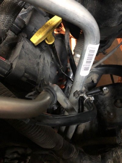

One stage of the install that I worked around was the removal of the oil dipstick. It involved unbolting the engine & transmission on the drivers side to raise the motor to get to one bolt down low on the dipstick. After looking closer, it looked like it would be very difficult and time consuming. I reshaped the bends on the dipstick while still connected at the lower bolt . The upper bolt was one of the 4 bolts that broke from manifold warp. After carefully reshaping the dipstick, I was able to get the clearance needed and was able to rework the upper connection to bolt to the strut support. The dipstick goes completely around the outside of the header.
Bottom line it's a difficult task but rewarding knowing I made it.
