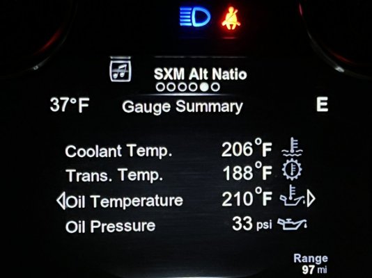

The oil pressure in my '15 SLT with 156k miles is around 40 at hot idle with oil temp around 212° F. Sometimes it will drop into the high 30's, especially if the oil temp has been higher and then cooled to that.
Makes me a bit nervous when I see it drop into the 30's at idle. Sometimes, I will shift to neutral and the psi will increase to ~40 psi.
Reason i asked about the tick is that so many of us here have suffered the broken exhaust manifold bolt issue, which shows as a tick at cold start that subsides after warm-up. Super easy to check for.

Checked oil pressure again after 45 min of driving… 33psi at idle
