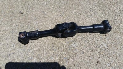

Well It's September 3rd, and here is what happens since July 25th, my last post. That weekend(July 27,28,29) I was taking my truck on a trip to Delaware and since the steering worked ok I decided to go the trip without installing the new steering rack I just received. I had made an appointment to have It looked at by the dealer that friday July 27th but decided to postpone it until the next wednesday, Aug 1st. My wife and I drove to Delaware Friday July 27 and drove all over and came back to central PA on Sunday July 29. The steering worked flawlessly UNTIL we hit outside State College, PA when we hit a big rainstorm. The power steering quit and I drove home tugging and yanking all the way home. Wednesday Aug 1st came and I took It to my RAM service department, they looked It over said there were no error codes for the steering rack but the problem is (here it comes) the steering universal joint unit that connects the steering wheel shaft to the steering rack. HOLEY COW @@%**%#! You know what that means! Here the universal joint was binding up and would intermittently work. As an electronic tech I thought for sure the electronic steering controller went bad, It just had to, there was no other solution, electronic stuff always fail, sooner or later! Well I paid them the $40 diagnostic fee and the had to order the part and would call me when It was In. So I left the service department with my tail between my legs and felt good It wasn't the steering rack that was bad. But I had a brand new one back home waiting to go in. I decided to go back to my garage and soak the steering universal with PB Blaster. It steered normal for a week after that, then the new part came in and was installed and they gave me the old part back. My truck has worked great since the new part install, so I did a Ebay return part call, on the new steering rack I had setting in my garage. The webpage from detroit Axle said there would be a 20% restock charge plus return shipping. They emailed the return label I put it on the box and two weeks ago shipped it back USPS (50 lbs by the way), they received It and gave me full credit, what I paid PayPal. I can't believe It, They are a great company!
So my steering Is now fixed. Now more on the electrical haywire incident. I earlier had removed the negative battery cable and disconnected my computer connectors, blew them out with low pressure air and applied Honda no-ox grease to the connectors, then to the big connector on the pass side of the radiator, then to any other connectors I could get to in the engine compartment. To date I have not had any electrical "Haywire" events in my dash display, thank God cause that really made me freak out. That's my story for know, sorry it's so long, but a lot happened.RAM 2015 STEERING SHAFT.jpg
