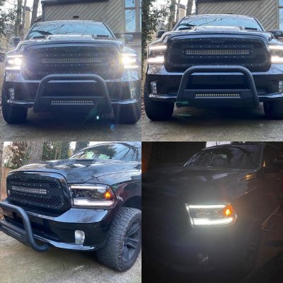

Hey all... been digging through the forums and google for this... is how i came to some of the changes I've made, but I cannot get the hyperflash and codes to go away no matter what I've done so far.
2015 RAM 1500 + Morimoto XB LED assembly.
Symptoms: L/R Turn Signal Bulb Out Alert... they ARE working. I've tried both sequential and static in the headlights with no change. Hyperflash turn signals in the door mirror lights (power fold) ONLY. Front and back are signaling at appropriate speed. Each change made was key off + 5 (or more) minutes separately. Side question: should i remove the resistors morimoto i have on the unit?

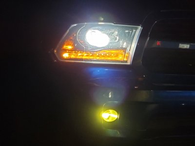

I installed the Morimoto XB Headlights on my 2015 Ram 3500 (factory projector truck). I am able to utilize the sequential turn signals with no hyper flash, maybe because it came from my dealer with a flatbed with led’s on it. My issue is that while test driving it last night, the headlights went OFF. They came back on after a few seconds, then went out again. I am running Morimoto’s resistors on the assemblies and changed the fog lights to led as well. I have ordered the AlfaOBD in hopes that it fixes the powering off issue. Headlight Revolution is also sending me PWM harnesses for the fog lights. I really like the headlights, but can’t have them turning off intermittently.

I installed the morimoto xb LED headlights in my 2015 Bighorn eco d (non projector), morimoto tail lights, and diode dynamics LED fog lights and couldn't be happier. I didn't use any of the "required" resistors for the headlights, have have no hyper flashing or bulb out codes.
I did use alfaOBD and changed the high and low beams to LED-present and also enabled the fog lights with the high beams!
Seamless install for me. I did not activate the sequential front turn signals though.
