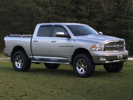

I used MaxTrac for my lift/level and put 37s on with no issues. Love their suspension lift. Went with the full 7" kit with Bils, which only lifts it by 4.5" after the level. Had to add a 1.5" coil spacer in the rear to keep it level.

Looks very good.... I don't want to go as high as you just looking for an increase in tire size of a couple of inches

My stocks were 33" actual, these 37x12.5s on the stock 20x9 wheels actually measure 35.5. Just saying that I highly recommend MaxTrac as the option for us 2x4 guys. And they are Nitto AT Terra Grapplers. If you were to go with an MT, definitely would rub. No rubbing with the ATs, though.
