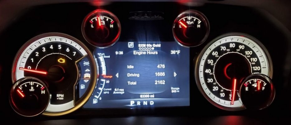

A couple months ago I upgraded the 3.5" cluster in my recently acquired 2014 Ram 1500. I bought a Premium 7" cluster on Ebay from the "Instrument Cluster Store". Very happy with their service and the quality of the panel. Prices range all over the place, but unless you are really lucky, it's more of "you get what you pay for". Some of the lower priced panels have lots of blemishes and scratches on the screen or broken mounting tabs. I paid $407 for a panel out of a 2018 Ram 2500/3500 with over 100,000 miles on it. It's not uncommon to see prices over $800. Just be patient until the right one comes along.
The panel is incredibly easy to swap out and also easy to program if you have alphaobd. I updated the odometer reading (my truck only had 63,300 miles) and the hour readings. Just remember to connect to the "Instrument Panel" module instead of the "Body Computer" module where most all of the other settings and adjustments are done. You can also change the "start up" screen so it matches your vehicle. I changed mine to "RAM 1500" but there are over 20 different startup screens to choose from - again, using alphaobd to make the selection. There are numerous youtube videos explaining how to do the panel swap and programming.
