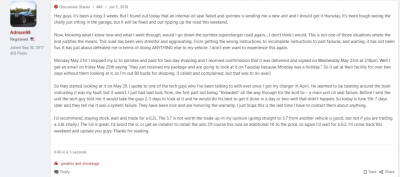

I am not the only one......
The latest on my end is that my wife now understands that looking for a V8 2500 truck is a good idea. [SEE FIRST POST]
We would sell her Honda Pilot though and have 2 trucks - her fathers truck for little stuff and a 2500 moving stuff.
Lets see if I can sell her on that idea, finally.
