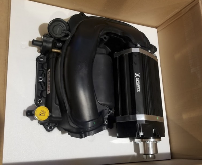

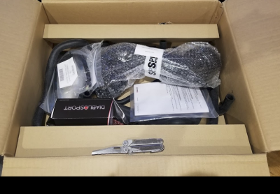

The engine hardware has arrived. It looks good and I am in the engineering / manufacturing world - it definitely looks the part on the outside. Nice work from Sprintex so far.
Nothing looks too intimidating so far. All the hardware and accessories are clearly labeled and the instruction appear to be rather detailed.
When the weather starts to clear up a bit around here, I will get the party started.
