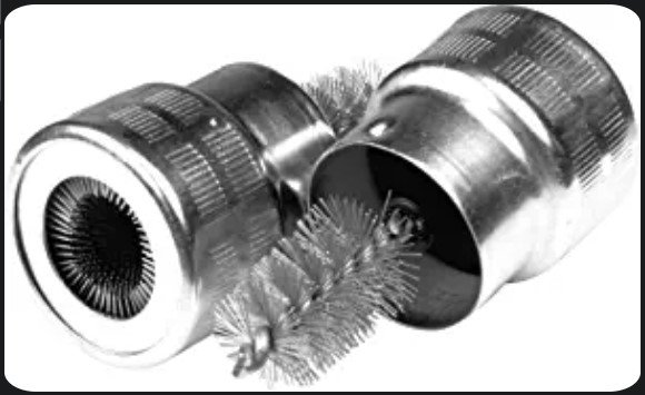

As mentioned, start with inspecting and/or cleaning up the battery connections, a battery load test, and test that the alternator is providing the correct charge voltage. With a high RPM (1300+) you should see about 14 to 14.5 VDC.
These are dirt cheap;
I would clear out those items before starting down the road of inspecting/cleaning/refurbishing ground connections because they can be much more time-consuming. Plus, without the correct power, your truck is dead in the water.
After the easy stuff is cleared, if you still have an issue, common ground points, it is. :cool:

Did you get a post/clamp cleaner like the picture I posted and clean both posts and clamps?
What is the battery voltage with the truck off?
Yes I got that cleaner. 12.06v
