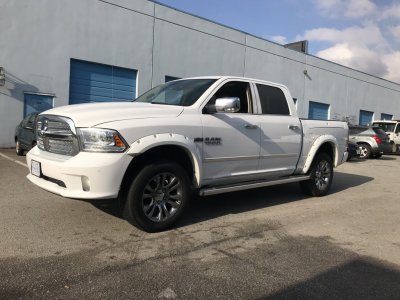

I have a 2015 ram 1500 laramie, which is a air ride equipped model.
I want to lift it approximately 2.5 to 3.5 inches.
Can it be done with leveling blocks or specific lift kits?
And how much would it cost?

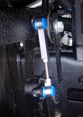

There's not anywhere to stick blocks really... I think there's a way to trick the air suspension to stay in its higher mode which might get you what you want?
Some people have converted their air suspension over to coil springs and then used regular lift struts and lift coils to do ~2"-2.8" lifts but yeah other than that you need a full lift kit, there's no cheap way to do it.

Interesting products. Do both work well in all the settings including entry/exit?
