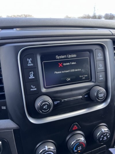

Just bought an 5.7 Hemi from 2015,
Thought of updating uconnect since I had just bought the car, of course with my luck it stops at about 70%, it doesn't show percentages. See attached picture, it stayed there until it got error 250(?), I think. If I start the car now, I only get the Uconnect logo and that's it, but if I insert the usb, it starts and will update. Anyone have suggestions on how I should do this?
Have used a Kingston USB 16GB..

Turn Key to the Run Position with USB removed.
Insert update USB when prompted. "Please Insert Update USB"
Remove USB Drive while Uconnect is checking the integrity of the ISO (during Pre-Update ISO validation).

And suddenly it appears «usb error»

do a fresh download of the update and possibly try a different USB. Format the USB before you copy the update files over.

I have done 2 different usb, and format both of them twice.. Same all over again.

Bought a brand new USB 2.0 16gb, and now i got the update!!! :D
