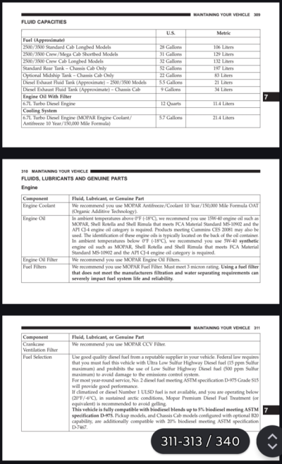

From the owners manual:
Organic Additive Technology (OAT) engine coolant is different and should not be mixed with Hybrid Organic Additive Technology (HOAT) engine coolant (antifreeze) or any “globally compatible” coolant (antifreeze). If a non-OAT engine coolant (antifreeze) is introduced into the cooling system in an emergency, the cooling system will need to be drained, flushed, and refilled with fresh OAT coolant (conforming to MS.90032), by an authorized dealer as soon as possible.
OAT for your ram.

My truck came with HOAT, the manual says HOAT.
Per the 2016 Ram Owner's manuals, both gas and diesel:
OAT is the only 10 year/150K mile coolant from Mopar, the HOAT coolant is a 5 year/100K mile.
Even both the EcoDiesel and Cummins that year use the Purple Kool-Aid OAT.
Mopar OAT is MS-90032
Mopar HOAT is MS-9769

My 700 page printed manual for my 14,says OAT in both 5.7 and 6.4 trucks.
Highly doubt they went back to Hoat for the 16's
Think i'd trust the factory manuals over anything you'll find online,like Bing.

Here is something you will not often read on Ramforum.com:
1. I AM WRONG. MY TRUCK USES OAT NOT HOAT.
2. THANK YOU ALL WHO PUSHED BACK AND MADE LOOK A THE BOTTLE I BOUGHT AT THE DEALER IN 2016.
3. Can anyone tell me how many quarts/gallons I need for a drain and refill.
4. Are there good off the shelf alternatives to the MOPAR brand?
In 2016 I went to the dealer to get a bottle of antifreeze to top off the fluid. I was aware of the HOAT/OAT issue and they gave me MS12106 which is purple. This was replaced by MS 90032 which is purple.
Thanks again for pushing back,
