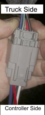

HELP! New guy here. Just bought a 2016 5.7 crewcab 4x4 Outdoorsman. 3.92 gears. It has what I need for towing except the brake control.
I took the Curt Discovery brake controller out of my Yukon XL when I traded it in. It doesn't have a plug on it. I bought a Tenosha Dodge plug and wired it to match color coded wires. Didn't work. Found a half ass picture on the internet and re positioned the wires in the plug. Now when the brake is applied I get the decimal point (no numbers)which indicates no trailer attached, when it is.
I've done a few brake controllers in the past without problem.. I am open for suggestions. I called the Curt tech line and the guy didn't have a clue.

Are you using the plug in adaptor already? If not check out etrailer.com and you will find one.

Did you check the fuse for under the hood? I believe it's F11
Is there a second trailer with brakes you could try(or have another vehicle check this trailer)? Also check the. wiring/plug on the backside of the bumper.

Ultimately I installed a factory brake controller that didn't work either. Took the dealer mechanic about 4.5 hours to track down a pin that had been bent over at the factory that was causing a short. It's fixed now. everything is working.

Thank you for letting us know the outcome/fix, glad everything worked out for you.
