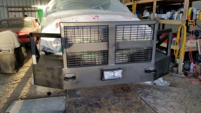

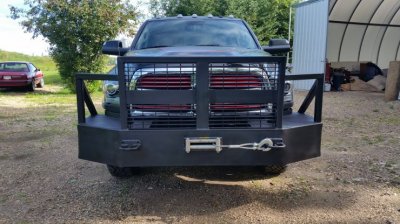

Actually, I don't intend on using a plow, I built a couple of bad ass bumpers.

Holy goalie mask! Do you drive around in An elephant preserve at night, or what? Lol
Seriously, nice fab work there!

at first it sounded like you were installing a plow. of course the truck would handle it but i dont think the springs would be very happy. but again, plows are extremely hard on the vehicle regardless how heavy duty it is. you should be fine with that bumper but check the door tag and see what it says. from what i can tell in the pics, your aproach angle clearance has now gone down the toilet but i suppose your already aware of that.

Power Wagon springs are weak compaired to the axles, with that kind of weight hanging out there I would suggest heavier springs

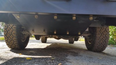

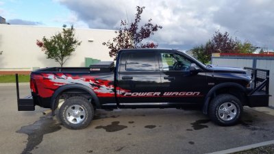

It's definitely heavy on the front end. Up here in northern Alberta we have a lot of deer and moose on the hwy especially in the winter. This truck is a hwy truck and not for the bush so I built it to survive direct impacts and also going into the trees if you leave the road. I wanted to be able to ensure no damage to the front, radiator, etc... and there is also a skid plate underneath to stop stumps and big rocks. I built a back bumper as well (pics coming shortly) to offset the added weight on the front - It has tailight protectors and concrete to ensure surviveability from tailgaters etc... This truck is now a tank! lol.

Does anyone know if the front coils are the same dimensions in the power wagon as in the 2500 and 3500? The wagons are higher, but I suspect instead of making longer coils, they simply moved the mounting surface to raise the vehicle - thus allowing them to use the same coils and not have to create specific coils for the power wagon.

theyre not the same coils. not by a long shot. wagons really arent higher either. regular 2500 has taller tires

power wagon coils are 2" longer. spring rates are different as well.

Yah, I've done some in depth studying on the matter - way different. It's actually not too bad so I might just live with it, but I am going to keep checking leads. It doesn't need much, in fact I'm looking at trying to find some coil overs to supplement the stock coils,
