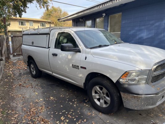

Thanks for the reply. Our current truck is a tradesman 1500 8' bed. The new one I was quoted on is the same thing but gas. Here's a couple of pictures of it. This is for my superintendent.
So are you saying that the bed is the same on HD trucks and not the 1500's or both?

The 2016 you had and the 2024 classic you are looking to get ..they are the exact same truck.
There is no 8 foot bed 1500 in the new body style.
The 2500 8 foot bed is the same bed still also...just some rework at the tailgate and taillights
So, yes...it will fit...it is literally the same truck

I work for U-Haul. U-Haul buys the 1500 tradesman single cab w/8’ box by the thousands. Literally, thousands each year. The 2024 Tradesman is the same DS body as the OP’s 2016. The camper should transfer. But, the OP should double check to make sure there hasn’t been some change I haven’t detected.
Yes the 6.4' and 8' beds are the same on the 1500 DS body trucks and even the latest model year ('24) HD trucks. I've attached the dimensions drawings for the 8' box, if you notice the file name notes DS/DJ which is the body codes (DJ is the HD trucks)

Sorry for the late reply. I thought I pushed reply last week, but it didn't post. I really appreciate the help. I am going to ask the dealer to bring one in for the agreed price and then go measure the bed to double check. I'll report back.

I was finally able to buy a new 1/2 ton with a long bed. It ended up being a v6 4x4 (we don't need four wheel drive). That is all that was left in inventory in the state for a long bed 1/2 ton so that's what we get.
The camper fit perfect. Thanks for all of the help!
