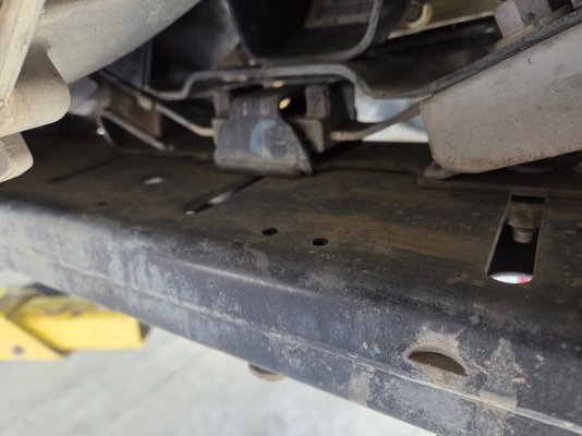

Alright guys. Teardown has begun. Almost ready to pull the t case. Noticed the trans crossmember is slotted. Hopefully the g56 mount will bolt in without issue. 20260718_103427.jpg

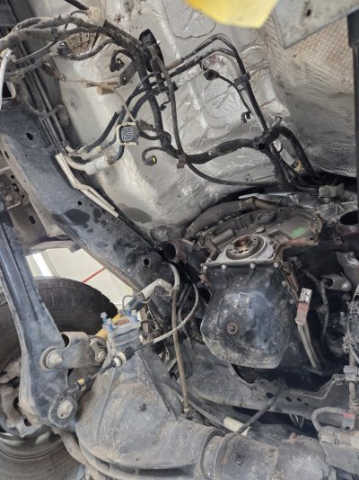

Everything is out now. Going to start installing parts next weekend. A little concerned about the fuel lines because they crossover right where the shifter will come up. May be able to get away with making up a couple brackets to push them one way or the other. All I know is that the easy part is over. Dropping a trans on the ground sucks. I ordered a trans jack since i have access to a lift.
