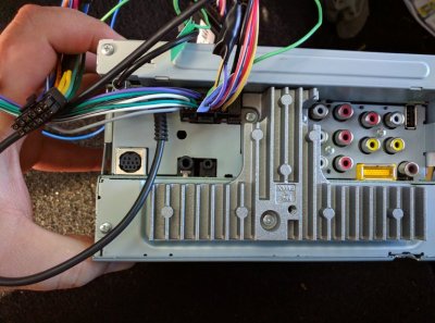

Ok I need help. I purchased a Pioneer AVH-X3800BHS and bought the install kit that Crutchfield says was the correct fit.
I'm not receiving any power to the head unit and I noticed after making my connections that the red hot wire is going only to a plug that is not being used making be believe that the harness is not the correct one.
The harness kit I ordered was the Metra 95-6518B. There is one plug that goes to no where and it is where the hot is going to. Do I have the incorrect harness?

Update. The harness kit number is Metra XSVI-6523-NAV XSVI Interface Dodge 13-UP. This harness just does not seem right for the 2017.
Update 2: After talking to Ryan at Crutchfield, they are telling me that the correct harness is Axxess LC-CHRC-01. So anyone that may run in to the same issue... there you go.

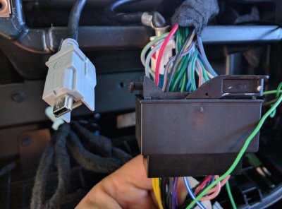

The 6523 is correct. The plug that is not being used should go to module box that should have been included with the harness.
C
Carodor
Mar 20, 2017
V6
The module box had its own connector but there was a third connector as well that had no where to go. The yellow wire in the Metra harness was going to the hot on the OEM harness.
