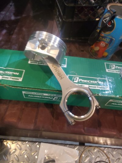

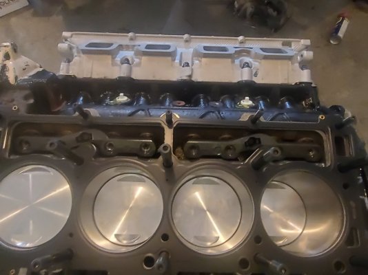

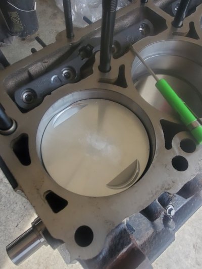

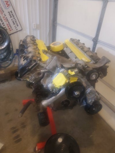

My engine lost a lifter at 126k in July and I've built a forged 426 with 10.5-1 pistons and a comp stage 1 blower grind cam (221,233*050, .594 lift 116 lsa) I'm still waiting on ARH to finish building my headers and y pipe. Replacing all the coolant system too and was looking for a larger capacity radiator since I'm going to buy one anyway.
