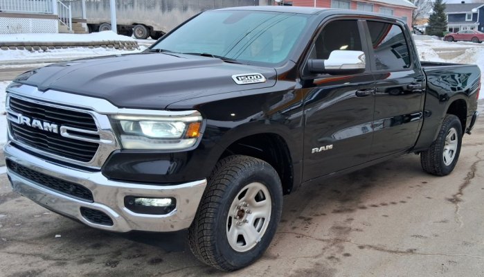

Well, had it looked at a shop near here. They did leak test and found head gasket is blown. Repair estimate was very (too) high. So... for a few days, before every use, I used a 500ml syringe to pump coolant from overflow tank back to radiator. At same time, I started shopping and I ended up trading it for a newer 2021 1500 Big Horn with crew cab, 6'4" bed and... 5.7L Hemi. Got it yesterday!
Congrats on your new ride.
You will have fun with the Hemi, especially if you drive it like you stole it.
They like to be exercised periodically. :cool:
