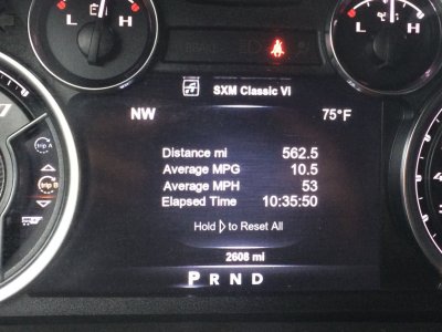

As an up-date, I pulled the battery cable while in Bristol at the Hot Rod Power Tour, reset the CEL, I had to drive home for a family matter, and everything was working properly. No CEL, No MDS problems, worked fine. Once home I checked for stored codes, there were none. I would suspect there would be, even though I reset the CEL with the old battery disconnect trick.
Just as an FYI this is wiIMG_3347.JPG th towing a 8000# travel trailer from NJ to Bristol Tenn
