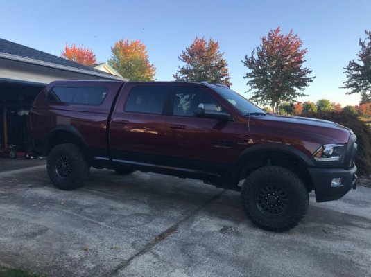

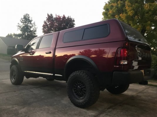

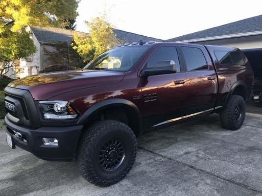

Just got these put on yesterday. Really happy with how they ride – balanced up perfectly with no vibes at all. A definite "MT singing" at highway speeds, but not anything I can't live with. So glad to get rid of the 315/70 KO2s –– I'm not sure BFG knows how to consistently make tires that are not out of round.
I'll be adding a Wilco hitch mount spare tire carrier and a full size spare in the next few weeks. The factory spare will have to do for now. The Toyo MT 35x12.5 was just too big to work in the spare tire location, even with most of the air let out. I got it all the way up in there, but it was pushing against/touching both the hitch and the sway bar.
View attachment 134147 View attachment 134148 View attachment 134149 View attachment 134151 View attachment 134150
5620065059152177cf2326938f9b44ac.jpgc1b487011a99e6d6a585718e9da0da07.jpge096e791c1eaf051ff489fe7e06c6f71.jpg
I specifically asked them not to install the screws and did it myself last night. Overall Discount Tire was great. They threw in a used 35 inch KO2 spare for free. They also nicked my wheels a little bit during install so they refunded me the price of one of the Toyos.
I was able to get my TPMS reset today. Set the thresholds to 30 PSI. I have the pressures set to 55 front 50 rear for now and will keep an eye on how they wear. I’m still waiting on my procal to show up.

The wheels are honestly a toss up to me. Both look great. Ref tire size though, I personally wouldn’t want anything bigger than the 35 without re-gearing.

To add to what I said by PM, I would probably buy the Kalta wheels in black if I were buying now. They weren't available when I bought mine, and I really liked the Savegres I had on my Wrangler a few years ago. Thinking of buying a second set of five to swap out with Toyo ATs for the winter months.

Yes, daily driver. About 11K miles and still look like new. No balancing or uneven wear issues. Balanced and rotated once and time to do it again soon. I think next time I will buy the AT version since I try to avoid mud but do need the best snow traction I can get. The muds seem to like to work me over into the ditch in deep snow unless I go to 4L and lock the rear. But that might be the limited-slip rear diff when not locked causing that behavior or just the weight of the vehicle without enough traction – not enough experience to know for sure.
