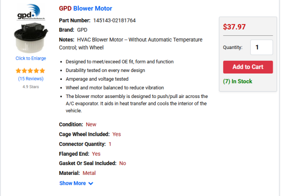

Here is the part that i purchased and used. Not mopar specific as far as i know.

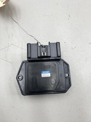

The Motor:
The resistor:

Is that a resistor or a control module. Looks like the wrong kind of attachment
When I want to see actual pictures of a OEM part, I usually look up a used one on ebay. Ebay sellers tend to have more actual photos. The OEM parts sellers like MoparPartsGiant usually suck for images.

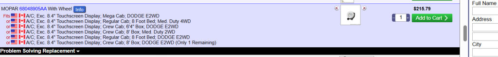

I bought a mopar part resistor, that was linked from rock auto in this thread, but for the life of me cannot figure out where it goes. The resistor that I remove is a wide, flat plug with several wires. The one you have above and the one I bought for my vehicle is a 2x2 configuration on the plug. Outside of just buying a mopar blower I have no idea what to try next.
Got pics?
What was the Mopar part# of the OEM, original, that came out of your truck?

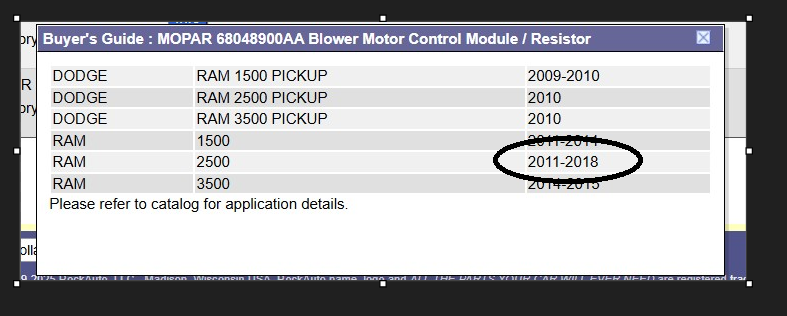

What was the part# on the RockAuto replacement. I looked your part up on several sites and they all show 68048900AA
When I look up a part on RockAuto, all I can do is enter the year, make,model. You'll probably have to be the one to open the box, verify that it's the right part, send it back if not, etc.

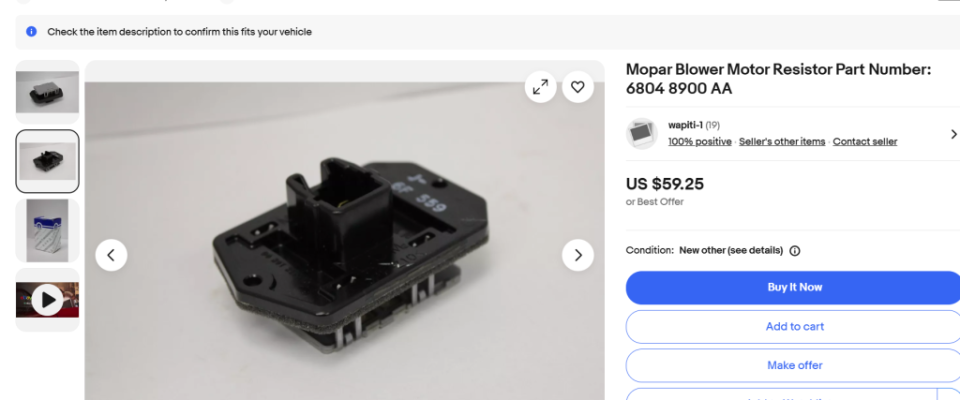

I went and looked in my truck, and it has the resistor that you described. My 2013 1500 has a wide, flat, 4 pin plug like you describe,
I wonder if there were two available for these trucks?
This is the one my 2013 1500 uses.
A used one on ebay.
Kinda weird, but when I look up that part# 68018105AA on RockAuto, it also shows up as fitting a 2018 Ram 2500. So, i'm not sure why there seem to be two different blower resistors that could have come on these trucks.
More likely, I think, Is that MOPAR got the fitment charts wrong and everyone else just copies off of them. So, everone is wrong.
My guess, the 4x4 plug like you got, fits 2009 thru 2012 and the wide 4 pin plug fits 2013 and up. But, that is just a guess.
Because RockAuto definitely shows both version as fitting a 2018 2500.
