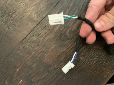

Trying to install in my 2018 Ram 2500, the blue and white wire only fits empty spots on the green side, the larger green and white wire doesn’t have any empty slots to fit in, there is one filled spot on the green side and one filled on the white. Any help would be greatly appreciated!
Sent you a pm. Thanks.

For the life of me I can't find the terminal blocks to plug the bypass plugs into. 2019 Ram 2500.
I also wonder if I was sent the wrong bypass. I ordered for 2500 but both connectors are white rather than one white, one green.
They are over on the side wall directly behind the headlight switch. There will be 2 CAN blocks right next to each other. One block will be black/green and the other white/green. Make sure you plug the leads into the correct CAN block based on the label on the lead. 2 white connectors is correct for your 19 HD.

Is that the same spot for the CAN blocks in the 2018 2500 as well?

Never mind, I found it..I only saw the white block at first.

I found it thanks to you. Had a heck of a time getting the connectors back off but done deal.
