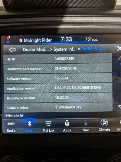

Do you have a UAQ 4c nav or the UAS 4c (w/o nav)?
What application version is installed on the radio? Go into dealer mode to check...
Press (temp up + down + front defrost for 6secs)
M² Mods.
Not sure who you're asking, but mine UAQ 4Cecfa6916735a0d8121c9fa4e4820bc8c.jpg

Application version 21.9 has known audio issues on both radios and UAQ v22.5 has had a few reports of problems. v22.6 is available for UAS radios and is fixed.
