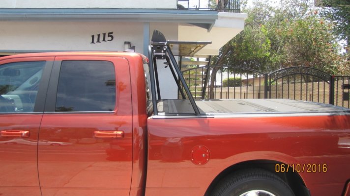

View attachment 474655Hello all, I recently bought a 2019 Ram Bighorn, and didn’t notice the odd gap between the cab and bed until I got home. I’ve seen pics of other trucks with the same issue and it appears to be some factory-made oddity? It came from Canada. Anyone know if this is an easy fix? I still have a few months left on the factory warranty if I need to take it to a dealer (bought it from a Nissan dealership).

It looks exactly like someone put to much weight in the bed of that truck. I’ve done the exact thing to a Silverado by putting a track hoe bucket back there and it did the same thing. Either you can take it to a body shop or if you know anyone with a backhoe and knows how to operate it throw some old tires in the cab side of the bed and have him push down with the bucket until it closes back up that’s what I did

No one in their right mind would consider that bend as "in spec". As mentioned earlier, it's either been wrecked, grossly overloaded on the tongue, or the bed was off and improperly reinstalled. If all the correct bed mounts are there, well..... The last time I had a vehicle that looked like that, i'd just been rear-ended whilst I was stopped with the brakes on. I wish you good luck!

Are there any marks on the back of the cab which would indicate it was hit from the rear and pushed forward. My Dakota was rear ended and the bed hit the cab. A frame shop pulled the frame straight within 1/8 of an inch but I could still see a slight wrinkle on the left side of the box. Also, look if there are any torch marks on the frame from underneath which would show the frame was heated up to straighten out the frame.

It does sound like all here are right about the accident occurence. If the frame and major components pass the inspection, you can always shim the box to rectify.

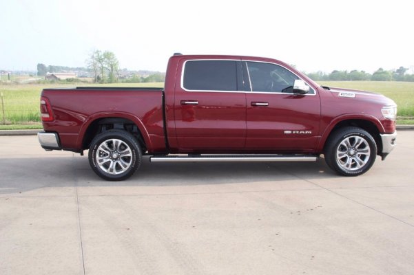

The 2019 bed is in alignment with the bottom of the window line
The image from the rear shows no sag
The Gen 4 Ram beds were approximately 2" lower than the bottom of the window line
