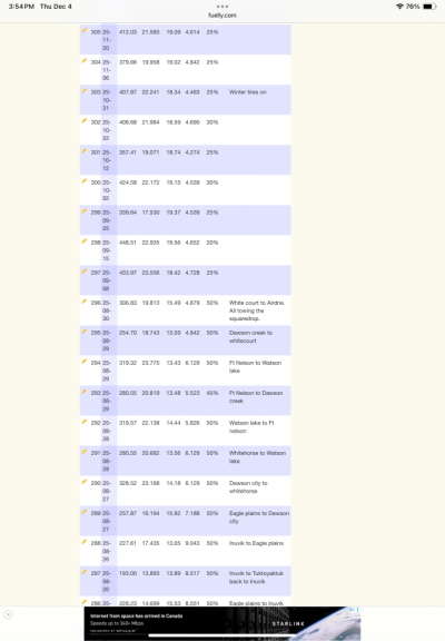

18-19 is normal on the hwy. Hilly, windy 75mph usual speed. When I drive through BC and the mountains averaging 60mph, I can pull 22-24. If mileage and cost savings are that important, I’ll take the Fiat which easily gets 37mpg when driver retardedly.
Also, never believe the lie-o-meter.
