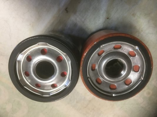

SOLUTION: I double checked to ensure the oil filter was tight and cleaned off all the oil with brake cleaner. The leak continued but this time I could feel a thin coat of oil on the exterior of the oil filter, so removed the existing Fram Extra Guard PH10060 filter and replaced it with a new one; the same oil filter I've used since the truck was new. Cleaned off all the oil again and two days later the drip returned. Watched an episode of Engine Masters where they compared several different oil filters for various attributes, so I thought I'd do the same. I went to my local AutoZone and compared an STP oil filter for my truck with the Fram. The rubber gasket on the STP filter was visibly wider and thicker. Bought and installed it, and the leak stopped. Ordered a Wix filter online and the rubber gasket on it is wider and thicker than the Fram. Don't know if Fram changed their specs or someone else is making this filter than before. Bottom line is I'm not going to use Fram anymore.
