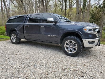

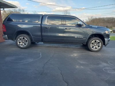

After taking measurements I was told 295s will not fit with my factory longhorn wheels. Apparently my offset is different then other factory wheels models and my tires would hit my upper control arm where the spindle is attached.
So I went with 275/65r20s. Still got my height and it's wider then the factory 275s. I love the look of them. 20200417_123854.jpg 20200417_123904.jpg 20200417_123914.jpg
So I went with 275/65r20s. Still got my height and it's wider then the factory 275s. I love the look of them. View attachment 203149 View attachment 203150 View attachment 203151
Looks like its sagging ass a little bit.
Really like that tire and wheel package!
That's what I think. I want to take it back down 1 setting. Or lift the rear not sure yet.

I've actuality thought more about a spacer in the rear.
Not sure if it will fit if I go down. I would have to take measurements before.
I'm thinking my cap is weighing down the truck just enough where it's below level.
I'm not too bothered by it though. Just wish it was about a half inch higher in rear.
Then just put a little spacer in the back. Boom, done.
